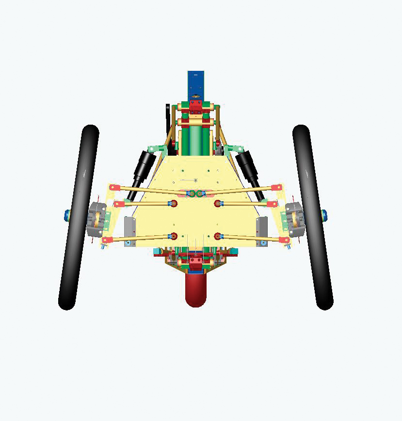

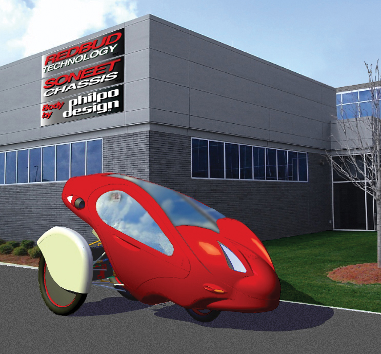

igus iglide self-lubricating, maintenance-free plastic bearings, from igus, are used in the design and development of a single-passenger, urban commuting vehicle.
The Personal Transport Vehicle – Ground or PTV-G is the brainchild of Redbud Technology out of Union Grove, Ala. The plastic plain bearings are used in both the independent rear suspension and in the rear wheel, lean-and-tilt mechanisms.
