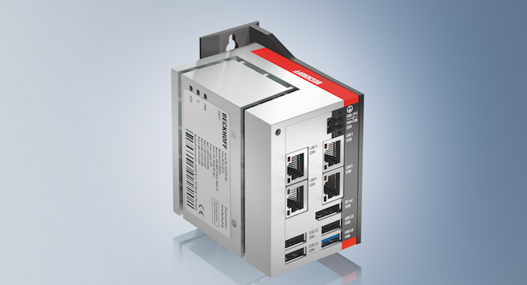

In order to improve coverage for all tasks in the fields of automation, visualization and communication, the C60xx series of ultra-compact Beckhoff Industrial PCs has been expanded with the addition of the new C6017. This latest addition to the Beckhoff Industrial PC (IPC) portfolio combines compact design and installation flexibility with an increased variety of interfaces and an integrated UPS.
industrial PC
With miniaturized dimensions, the C6017 is almost identical in design to the popular C6015, currently the smallest ultra-compact IPC from Beckhoff. The success of the C6015 quickly created additional demand, especially from applications that have increased requirements for connectivity and data security in the event of potential power supply failures. The C6017 was developed precisely for these requirements: the existing C6015 configuration with DisplayPort connection, onboard dual Ethernet adapter with two 100/1000Base-T connections and USB 3.0 and USB 2.0 ports, is being extended on the C6017 by adding two RJ45 and two USB 2.0 interfaces. Moreover, an optional capacitive 1-second UPS is integrated, ensuring reliable storage of persistent data in the event of a power supply failure.
With dimensions of 82 x 82 x 66 mm, the size of the C6017 is similar to the C6015. Only the overall width is extended by a mere 24 mm. Equipped with an Intel Atom CPU with up to four processor cores, the passively cooled IPC also features a robust aluminum and die-cast zinc housing. This means the C6017 is ideal for automation, visualization and communication tasks up to the mid-performance range.
The new ultra-compact IPC series from Beckhoff meets today’s demanding requirements in machine building, such as increased modularization, reduced space requirements in control cabinets, higher processing power and competitive pricing. Designed precisely with these requirements in mind, the new device generation is well-suited for a broad range of applications, for instance in distributed topologies and advanced IoT or Industrie 4.0 applications.
