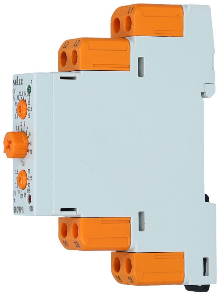

This protection relay — which actually protects motors and other loads against undervoltage, overvoltage, phase sequence problems, and phase failure — is a 600VPR-170/290-CU from SELEC. It has an operating range of 170 to 290 V with an adjustable trip delay time from 0.2 to 10 seconds. The voltage protection relay mounts to DIN rail. Image courtesy Automation24 Inc.
