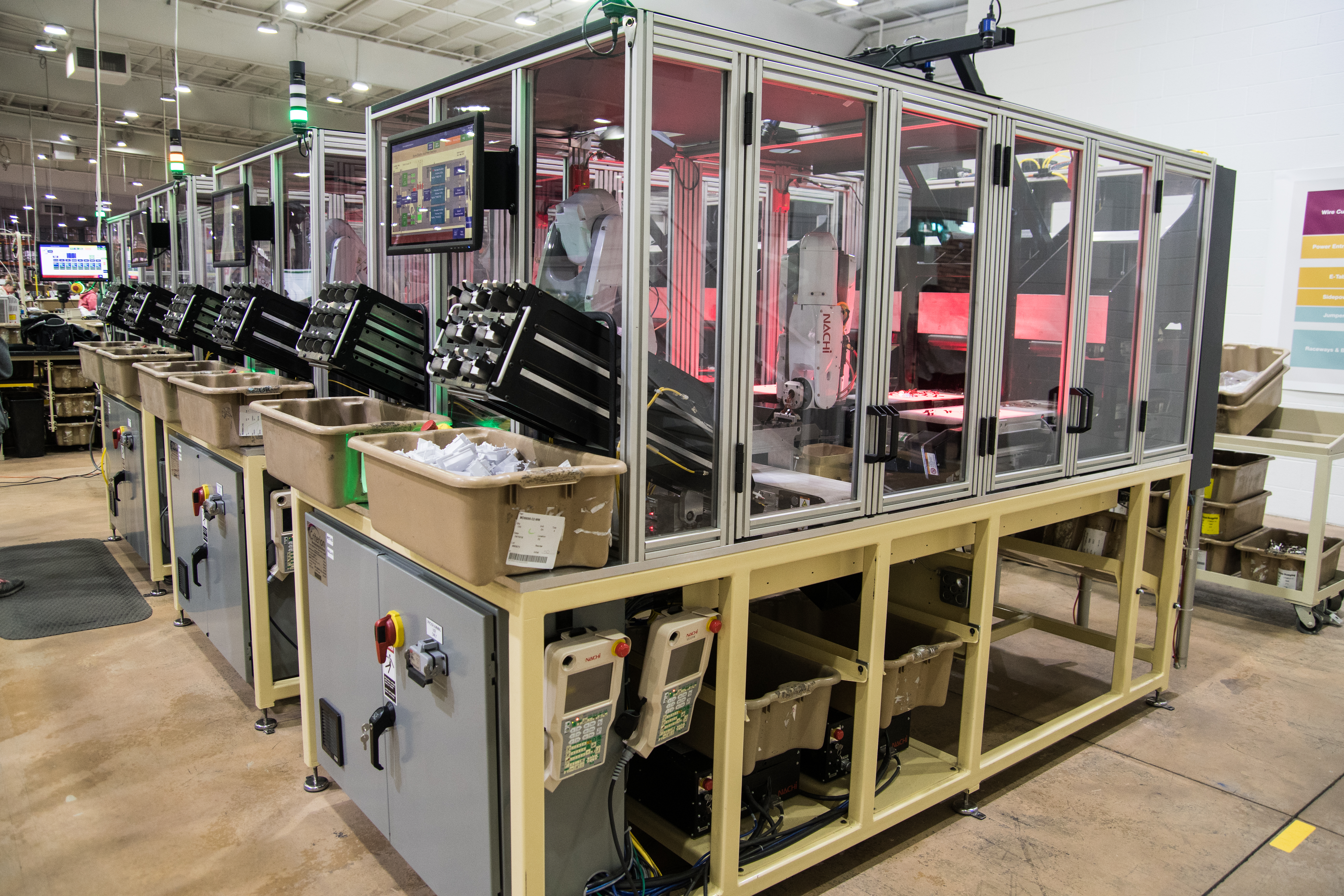

A trio of robotic assembly cells — each with its own threesome of busbar conveyors and solo output conveyor — build electrical outlets for modular office furniture. Then one packaging cell at the end of the line collects the output from these assembly-cell feeds for final testing and shipping.
Byrne’s automated installation processes busbars in four different line, four different neutral, and three different ground variations … and it handles six different outlet body variations. That means the whole installation can output several dozen electrical-outlet models — each requiring dedicated vision-system programming for successful robot picking. In fact, sometimes operators must empty the hoppers (via an easy-purge dump and quick conveying back to a parts bin) for switching the output product several times a day.
1. Operators set the parameters for the current job via a human machine interface (HMI) based on the specifics of the current order being processed — including parameters such as color, size, needed outlet count per case, and so on.
2. Operators then load the outlets’ front shells and back plates by hand on one side of a machine … and put metal bus bars into hoppers on the other. “Each electric outlet has five parts — including three busbars for line, neutral, and ground. Each busbar has its own hopper and conveyor-based sorting line to let us take these raw components and basically dump them into hoppers. Then each hopper drops busbars onto a cascading three-layer conveyor system,” explained Byrne engineer Dan Wierenga.

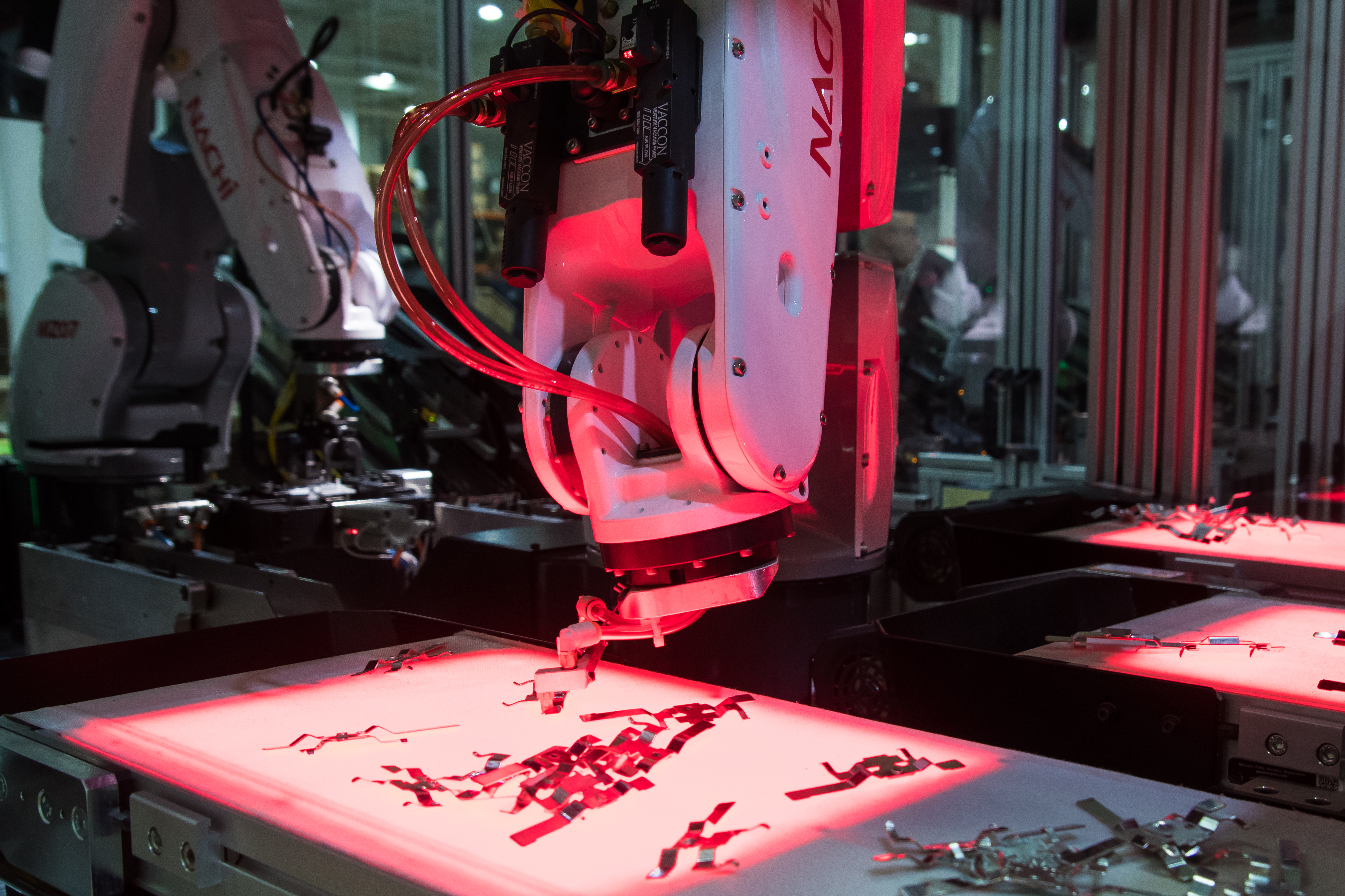

A robot picks parts and places them into a holding station. Any parts that can’t be picked because they’re stacked or misshapen get dropped onto a third conveyor back to the hopper to go through again.

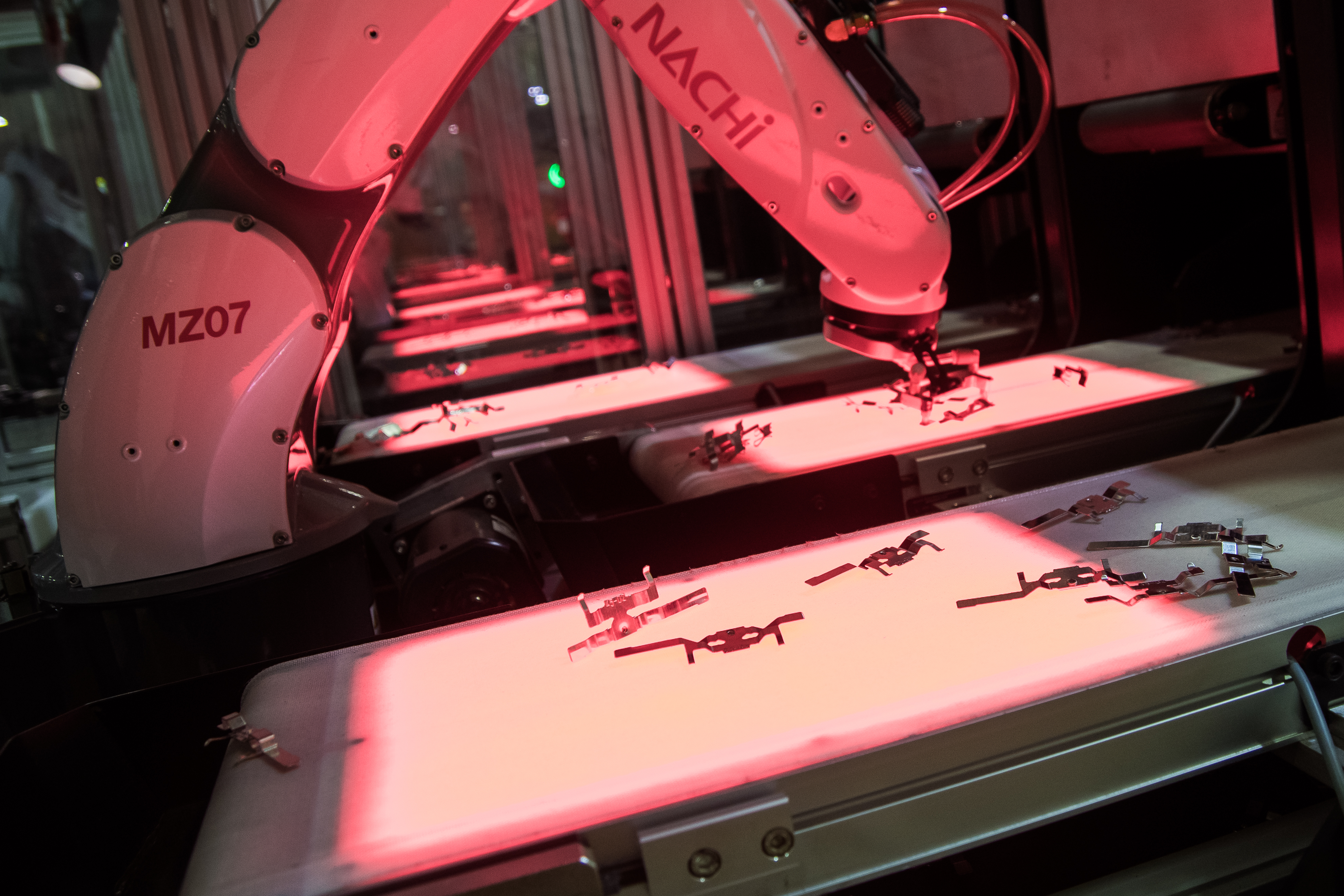

3. The first of the three conveyors moves very slowly and drops busbars onto a faster middle conveyor (in a way that spaces them evenly). In the middle of this conveyor is an underlit section — provided by Spectrum Illumination. The underlit conveyor region is monitored by a Datalogic vision system.

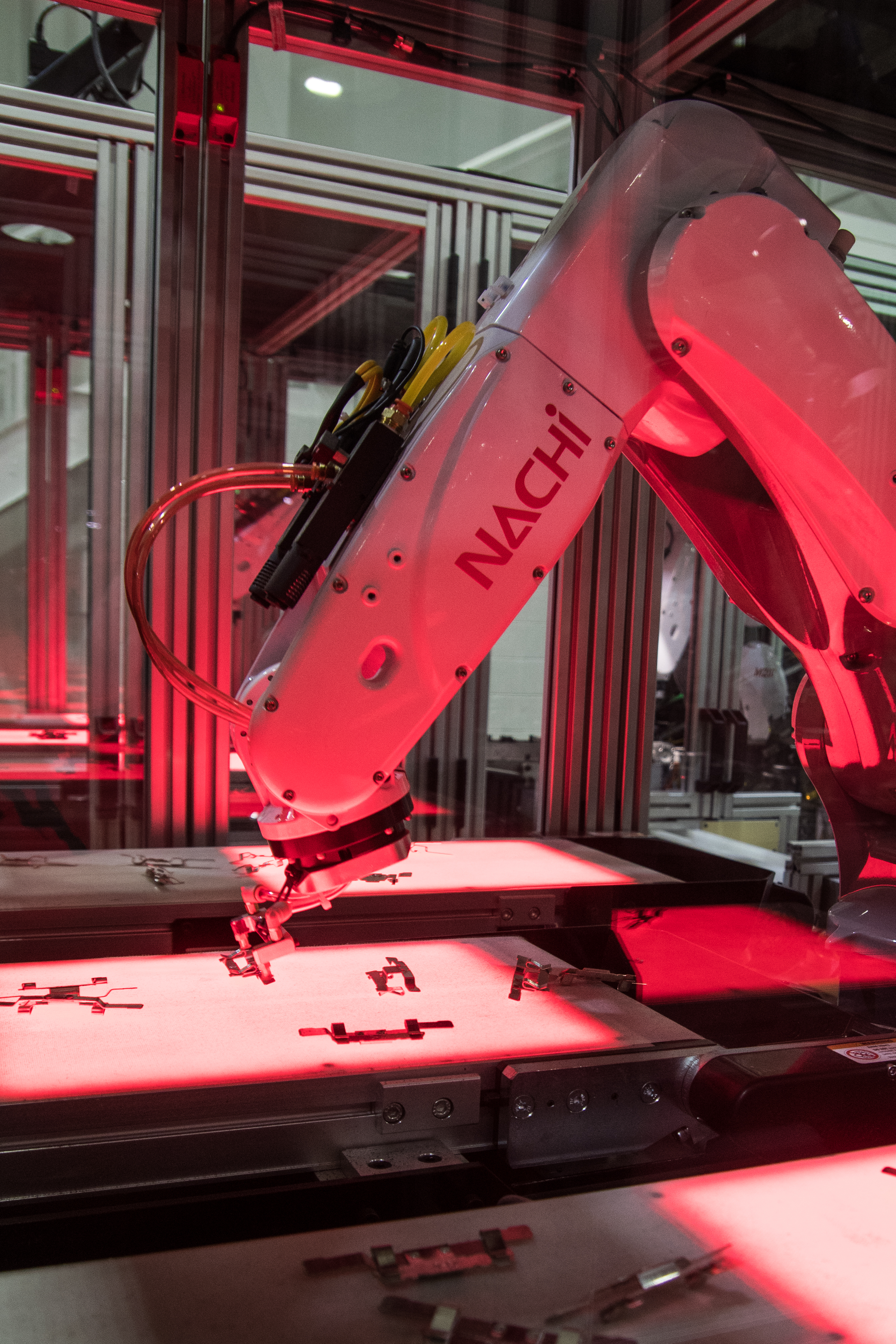

As busbars travel over the underlighting, the vision system confirms they’re right-side up and clear of other parts — and then commands the conveyor to stop to allow pickup by a robot. Any busbars that are bad, misoriented, or clumped together continue onward until they fall onto a third (fastest-moving) conveyor that (via an elevator) returns them to the original hopper. Next a Nachi six-axis robot gets the X, Y, and angle of the busbar, grips and reorients it, and puts it in a holding station.
Conveyor backlights on 9 of 28 conveyors from QC Conveyors illuminate items above through a cutout in the conveyor frame and the translucent belt. The lights provide contrast to let a vision system inspect the parts and find good ones; find parts that aren’t stacked; and orient a robot arm servicing the conveyor to pick the parts.

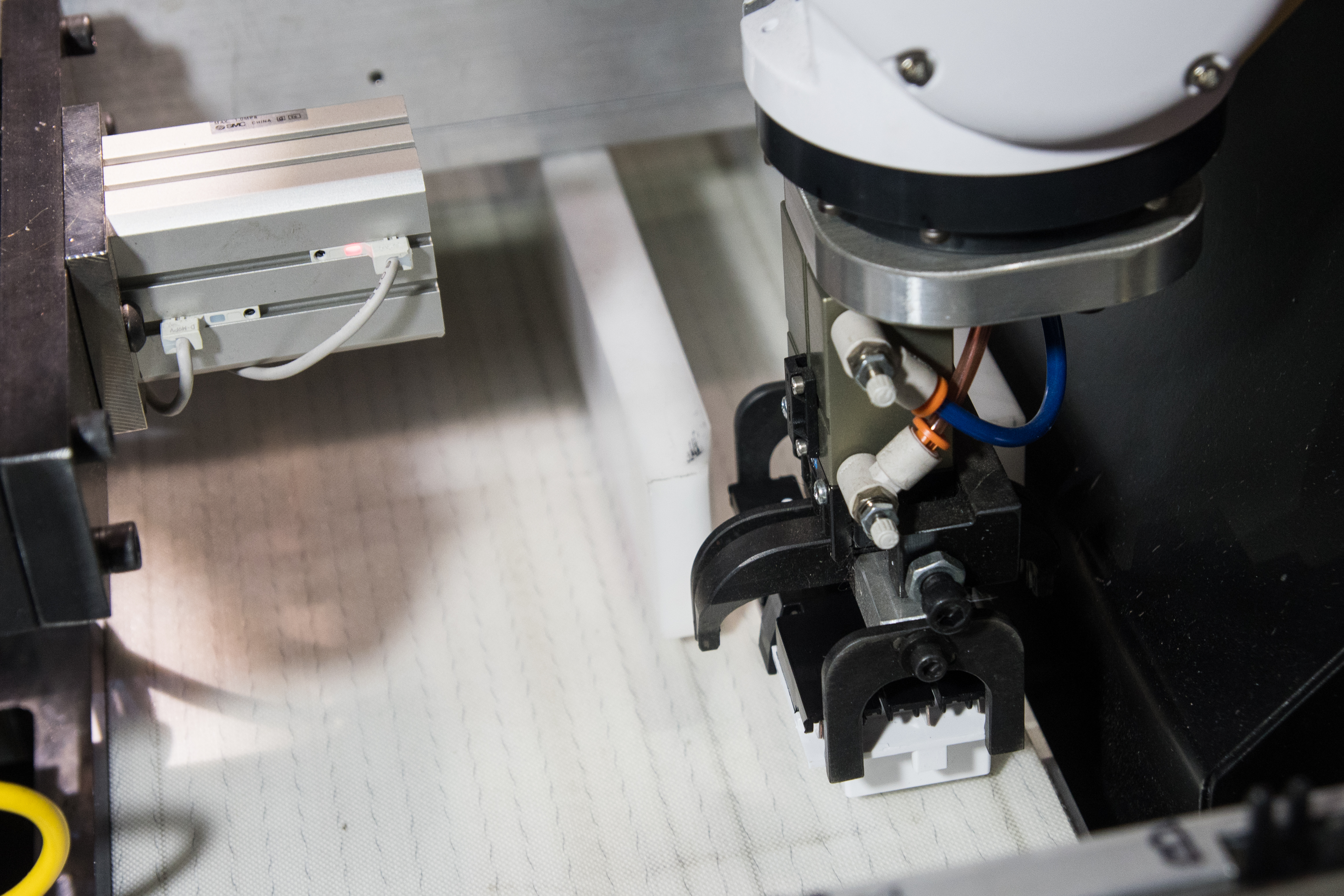

4. Another robot takes the first of two plastic halves — the outlet’s front shell— and puts it into a nest. Then it picks three busbars (readied by the previous robot) and inserts them into the front shell. Then the robot puts the outlet’s back shell half on the front and presses them together. For there, the robot places the completed assembly on another conveyor (from QC Conveyors) to inspection and packout.

Nine busbar hoppers and six outlet-body inputs feed three assembly cells.
