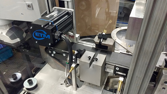

Dorner Conveyor and Electric Torque Machines helped improve the material handling setup inside the Pennsylvania facility of American Axle Manufacturing.
The direct-drive motors have high continuous torque density (particularly at lower operating speeds) to eliminate the need for a bulky gearbox. Integrated into Dorner’s 2200 Universal Drive — which includes the motor, configurable motor mount, and controller — they reduce the conveyor-drive size by nearly 70% while boosting functionality and maintaining required output torque.
“We chose Dorner’s Universal Drive for its unique motor,” said AAM facilities engineer Michael Vandervort. “The motor is smaller and lighter than traditional ac motors … and can run in designated working areas unguarded, because the motor runs cool. In contrast, traditional ac motors are too hot to touch.”
ETM’s direct-drive motor imparts advanced functions to simplify automated tasks.
Vandervort also cited the wide speed and torque ranges of the Dorner Universal Drive as key benefits. “The drive lets us use the conveyors for applications such as slow pass-under vision tasks; heavy accumulation tasks; and high-speed part transfers.”
The on-conveyor inspection function is especially challenging. “At our facility, we use a lot of small conveyors to move light loads. Electric Torque Machines developed motor tuning functions to help stabilize our vision imaging on pass-under applications with very low torque requirements. We really appreciate ETM working with us and developing solutions for our specific needs,” Vandervort added.
