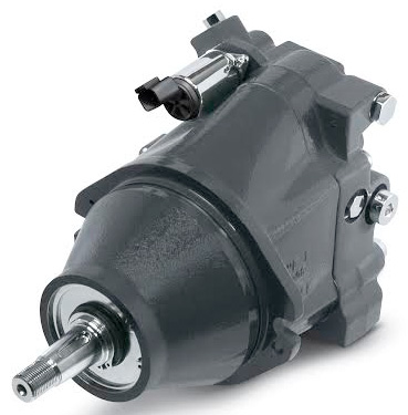

Danfoss is pleased to introduce the innovative Reverse Displacement Motor (RDM). The
open circuit piston motor offers reverse circuit functionality without external valves — an
unprecedented hydraulic system solution for mobile equipment applications. The RDM enables
customers to achieve up to 10 percent power savings, a 15 percent average reduction in total
system cost, and reduced system complexity.
The RDM is built on the proven efficiency and reliability of the L/K Axial Piston Motor from
Danfoss. The compact motor features a 12V integrated proportional shifting valve that allows
smooth, on-the-go reversing using system pressure. This simplified design eliminates the need
for additional components, cost and pressure losses associated with the external valves and
pressure supply necessary in typical reversing solutions.

In addition to fan drives, the RDM is well-suited for a full range of applications with the need for reversing capability, including conveyors, auger boring machines and directional drills.
In fan drive applications, the RDM is designed to protect the equipment. In the event of a
controller or electrical failure, the fault position of the motor is biased to maximum forward
speed, enabling the fan to maintain the integrity of the cooling system on the machine.
