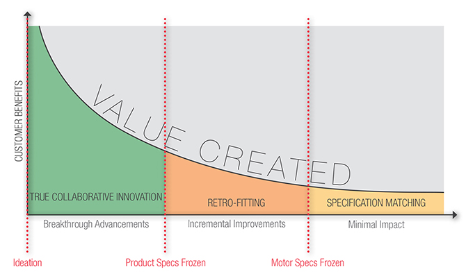

Early collaboration between OEM or design-engineer and the motor manufacturer can make for optimized designs. Image courtesy Portescap
