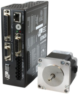

An AC input stepper drive form Applied Motion. A compatible stepper motor is also shown.
This is because current affects how powerful the electromagnets in the stepper motor are. More current flowing through a stepper motor’s coils means a more powerful electromagnet.
An AC drive can supply the high currents necessary for such operation. This is because AC-input drives are able to use higher voltages. Ohm’s law states the relationship between current and voltage is I=V/R, with I being current, V being voltage, and R being resistance (or in alternating current’s case, Z, impedance), the more voltage, the more current. Because DC drives usually run at lower voltages, they often cannot provide the high currents necessary for such high torque operation.
