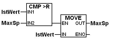

PLC function block diagram
A sample of a function block diagram showing typical function blocks connected together. (Image source: Wikipedia.)
In FBD, function blocks describe the function between input and output variables. Inputs and outputs of blocks are connected together via connections or lines in the programming environment. The block represents some function or other; for example, it can be an elementary function such as MOVE or COMPARE, or a typical logic function like logical AND or logical OR.
The idea behind IEC 61131-3 was to have a vendor independent standard for PLC programming languages. The FBD language is structured as a logical sequence of functions, with the direction of execution being from left to right. Input values have to be generated before function block execution, and network evaluation isn’t finished unless all the output values are calculated.
