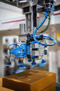

As manufacturers work to reduce cabinet complexity and move I/O closer to the application, Festo will present new functional additions to its VTUX valve terminal platform.
The IP67-rated VTUX combines pneumatic control, vacuum generation, and I/O in a modular platform that can be mounted near the application. This design can reduce tubing runs, cabinet space requirements, installation effort, and the number of separate automation components on the machine. Integrated vacuum monitoring provides additional visibility for troubleshooting and can help reduce compressed air consumption. The VTUX is also suited for end-of-arm tooling applications because of its compact and lightweight design.

Festo will display adaptive gripping and vacuum technologies intended to improve handling reliability and simplify end-of-arm integration. These include vacuum generators, suction cups, and the HPSX adaptive gripper for both traditional and collaborative automation environments. The HPSX is a hygienic soft gripper that uses food-safe silicone fingers to handle delicate and irregularly shaped products without tool changes. It is intended for use in food, pharmaceutical, and cosmetic applications.
