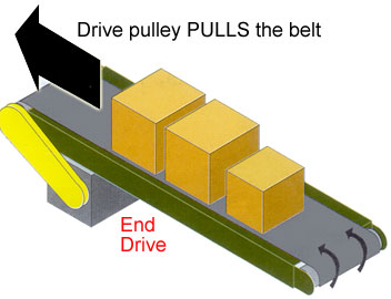

Conveyor end drives: heads or tails
conveyor drive
An end drive on the discharge side of the conveyor is referred to as a head drive (shown here). Alternatively, an end drive on the infeed side is referred to as a tail drive.
Image credit: Cisco-Eagle
A drive located at the head or tail of the conveyor is generically referred to as an end drive. However, to designate which end the drive is located on, manufacturers typically refer to drives located at the head, or discharge end, as head drives and those located at the tail, or infeed end, as tail drives. But it’s important to note that some manufactures use the term “head drive” in a more generic sense, simply to denote that the drive is located at either end of the conveyor, as opposed to somewhere along the length of the conveyor.
A head drive — located at the discharge — is the preferred configuration for most conveying applications, as it creates a “pull” force on the conveyor belt or media. A notable exception to this is a declined conveyor, where the weight of the transported load or the angle of the conveyor would create a “pushing” force that overrides the ability of the drive to control the conveyor’s movement. In these cases, a tail drive — placed on the infeed, or higher side, of the conveyor — would act as a brake to prevent the load from driving the conveyor.
