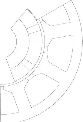

The low weight of the motor pretty much dictated that a high-energy Neodymium-Iron-Boron magnet be selected that could simultaneously handle the specified torque over the temperature range. Such component specs for the Military usually push the design envelope. The major criterion here was to keep the soft iron flux density in the stator below 17 kgauss.
A special stator winding was designed to interface with the Neodymium-magnet rotor. Although this was a custom design job, not enough time was available to produce a totally new stator lamination geometry, so an existing stator was chosen. A “T-segmented” stator lamination was selected to obtain the maximum stator winding slot area for the highest copper volume.  The stator winding that can be used with T-lamination teeth is defined as the fractional pitch winding that wraps directly around each lamination.  It is the shortest mean length of a copper turn possible which can minimize the phase resistance and develop more than sufficient motor torque.

The output of the SPEED program gives designers a clear view of the flux paths and geometry of the stator and rotor of a well-designed motor—which was achieved only after a series of iterations. The goal here was to keep the soft iron flux density in the stator below 17 kgauss.
