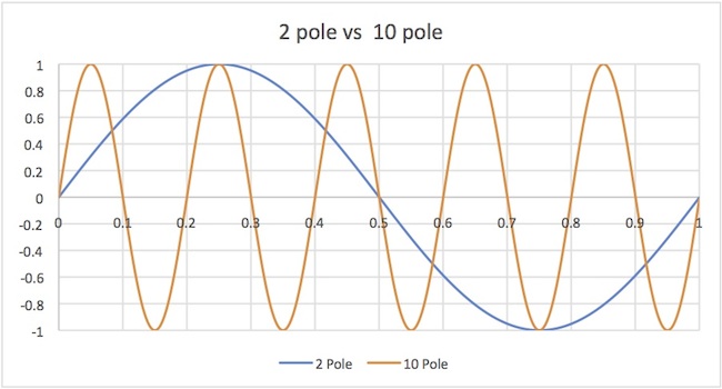

How it works: For the same rotor dimensions and gap flux, for a given speed, the rate of change of gap flux varies directly with the number of poles, as the frequency of the variation varies directly with the number of poles. Given the same winding window, for a given drive current rating, the number of turns is almost constant (although some designs do allow for a slightly larger fill factor, thus a few more turns). The result is that the back-EMF  drive current increases approximately linearly with the number of poles. As the back-EMF constant in V/Radian/sec equals the torque constant in Nm/A, the continuous torque thus increases with the number of poles. In the above graph, the higher rate of change of flux with angle is apparent for the higher pole count rotor, even though the magnitude of flux for both motors is equal. For a given number of turns on the stator pole, the back-EMF generated is given by

In this graph, the higher rate of change of flux with angle is apparent for the higher pole count rotor, even though the magnitude of flux for both motors is equal. (Image courtesy of QuickSilver Controls, Inc.)
