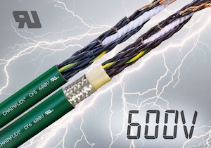

East Providence, R.I. – igus has significantly upgraded two of its top-selling cables designed for flexing applications on automated machinery. Chainflex® CF5 control cables and shielded CF6 cables now comply with 600-volt AWM styles. The new, improved cables are available immediately from stock and at the same price as before.
By increasing the operating voltage to 600 volts, CF5 and CF6 control cables can now connect to motors worldwide — particularly in the US, where many motor applications require 480 volts. In addition, the new 600-volt cables can be used in applications where local electrical codes require cables to be the same voltage, regardless of their actual function. For example, if a 600-volt motor-power cable is used, any other cable installed alongside may also need to be insulated for 600 volts — even if it operates at a lower-operating voltage.
The new control cables have an outer PVC jacket that is resistant to oil, according to DIN EN. The conductors are bundled in very short pitch lengths around a highly tensile-resistant rope core and the copper stranding is optimized for dynamic use inside a cable carrier. These design features significantly increase the durability of the cables. The CF6’s specially designed, braided shield, which has 90% coverage, has high EMC protection guaranteed even after millions of cycles.
