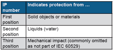

Ranging opinions about the meaning of IP ratings is frustrating, but actual definitions are very specific. Published by the International Electrotechnical Commission (IEC) and detailed by IEC standard 60529, IP ratings—also known as Ingress Protection ratings or International Protection markings—rate the protection components provided by mechanical casings and electrical enclosures against intrusion (including body parts such as hands and fingers), dust, accidental contact and water. In other words, an IP rating indicates how well the enclosure of a device shields internal subcomponents. The ratings include two or sometimes three numbers.
ip-rating-chart
