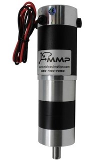

Midwest Motion Products has introduced the D22-376D-24V GP52-014, a brushed 24V DC gearmotor designed for compact, durable motion control applications. The unit delivers up to 23 in-lbs of continuous torque and 61 in-lbs of peak torque at an output speed of 275 RPM. It features IP54 protection and a compact design under 2.5 inches in diameter.
Description:
  • IP54 rated; measures under 2.5″ in diameter and 8″ in total length; weighs 3.8 lbs.
  • Datasheet available for download.
  • Rear shaft options include encoder-compatible, brake-compatible, or both.
  • Samples can typically be assembled from stock materials within 1–2 days.
  • Production lead times are generally measured in weeks.
