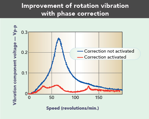

Oriental-Motor-chart-rotational-vibration
This is just one example of how controls address vibration. This plot shows phase correction with a CVD228-K and PKP266D28AA two-phase motor and bipolar driver package from Oriental Motor. Notice how activating phase correction dramatically decreases the peak vibration value.

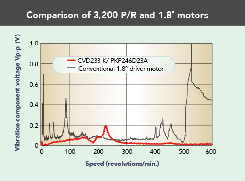

Case in point: One proprietary option for smooth driving enables good low-vibration operation from a microstepping driver with the flick of a dip switch on the driver circuit board. The smooth-drive function automatically controls the motor’s microstep drive operation at the same travel and speed as in full-step mode, without making the operator change speed settings of the driver’s pulse input. So the function eliminates the need to increase pulses to the driver.
Consider how most microstepping drivers offer resolution to 0.007° or 51,200 microsteps per revolution. In contrast, vibration-suppression stepper drivers that take the form of two-phase bipolar drivers automatically microstep 0.0008° or up to 2,048 steps per full 1.8° step of the motor. With the smooth-driving feature enabled, the drivers significantly improve overall performance across all speed ranges, not just at slower speeds — drastically reducing vibration that can cause step errors. This gives design engineers a wider design window of motor speed with a set level of performance.
Oriental-Motor-comparison-drivers-and-vibration
The 3,200 P/R is a 0.1125˚ per-step motor. A CVD vibration-suppression two-phase bipolar stepper driver (running a proprietary Smooth Drive algorithm) automatically microsteps up to 0.0008° or 2,048 steps per full 1.8° motor step. In this way, Smooth Drive significantly improves performance at all speeds, and not just lower speed ranges — drastically reducing vibration that can cause step errors.

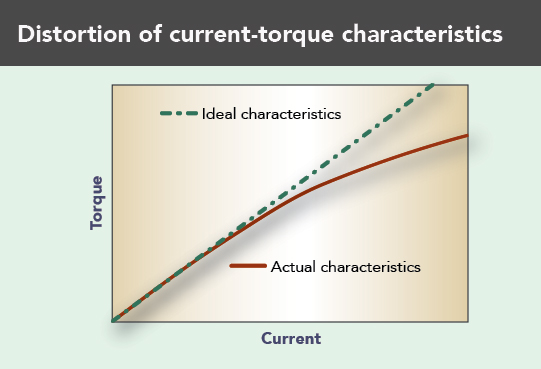

Another way to smooth motor output is to minimize torque ripple, which is the fluctuation of output torque when changing excitation phases. Here, some algorithms correct sinusoidal current into the motor.
If the relationship of the motor current and generated torque were a linear form, torque ripple wouldn’t arise from current changes at each phase to a sinusoidal wave.
However, the relationship of the motor current and generated torque is not linear. Therefore, torque distortion arises when changing current at each phase of the sinusoidal wave. This happens when current is high — and that in turn causes vibration. So dealing with high output torque and low vibration at the same time requires an additional control.
Oriental-Motor-plot-current-torque-distortion
As current becomes higher, that applied to the windings exceeds rated current (defined by magnetic saturation caused by armature reaction of the magnetic flux). Then the relationship of current and torque gradually becomes non-proportional. Getting the most from stepper motors requires that designs work around this behavior.
To solve this issue, some vibration-suppression stepper drivers appropriately correct the phase of the sinusoidal current supplied to the motor, known as phase control — or properly switch the electrical phases at critical times. These switching times are based on the most common characteristics found in stepper motors. As these characteristics are unique from motor to motor, such drivers use proprietary phase control technology for specific motor sizes and input currents to get ideal performance.
The program does this by matching rated motor current to driver current. In other words, it matches the maximum current value of the motor to maximum of the driver — for example, a 2.8-A motor to a 2.8-A driver. This phase control corrects the distortion of current-torque characteristics, so it concurrently mitigates low vibration and maintains high output torque. This in turn improves stop-position accuracy.
Activating phase correction dramatically reduces peak vibration values. The optimized level of phase correction depends on the motor’s magnetic properties, so the correction value is best set to cater to specific motor-driver combinations. That’s why vibration mitigation with this method depends so heavily on well-paired motors and drivers.
