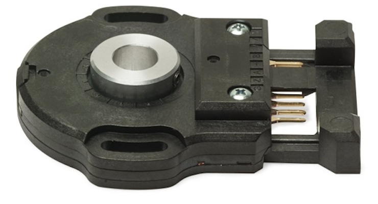

HEIDENHAIN’s RENCO brand RCML15 rotary encoder has been widely used as a preferred feedback solution in automated medical devices throughout the world, and is now commonly found in motors being made for blood pumps too. The encoder’s slim and lightweight design combined with its reliability make it a popular go-to source for feedback in this industry.
The RENCO RCML15 rotary encoder is particularly noted for its modular design without an integral bearing. Its special properties are its compact design with a low profile at a height of only 8.9 mm, as well as its easy, self-centering mounting thanks to a patented slide lock mechanism. With its OPTO-ASIC technology, the RENCO RCML15 offers the greatest functionality with the smallest possible dimensions.
Installation Length: 49.0 mm
Operational Length: 42.4 mm
Width: 38.9 mm
Height: 8.9 mm
encoders
The RENCO RCML15 rotary encoder currently provides motion and speed feedback in blood pump motors which operate within a multitude of medical devices such as hematology analyzers, which are automated systems that count leucocytes, red cells and platelets in blood. The RCML 15’s slim and lightweight design allows motor designers more flexibility, especially in these applications where space and weight is critical. By combining the brushless motor commutation pulses and incremental position feedback into one package, while improving the performance and reliability of the brushless motor/encoder package, motor manufacturers can reduce the costs while also providing top-of-the-line performance.
