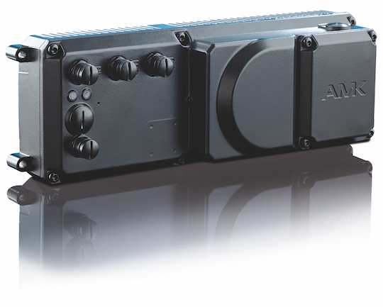

The iSA decentralized controller from AMK is suitable for modular machine construction. Subsystems only have to be connected to three-phase power and incorporated in the control system via the real-time Ethernet interface.
