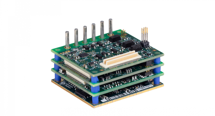

Copley Controls has introduced the Nano Series of digital servo drives. Featuring best-of-class power density and thermal management, these compact units integrate easily into autonomous guided vehicles (AGVs), autonomous mobile robots (AMRs), robotic joints and other automated equipment that need precise speed and position control despite limited space.

The Nano Series comes in a small footprint of 35 x 30 x 23.4 mm, operates from 9 to 180 Vdc input voltage and delivers up to 35 A of continuous current and 70 A peak current to provide exceptional power density and efficiency. The Nano Series’ compact size also gives integrators the flexibility to mount the units directly onto the motor or within robot joints. The optional connectorized PCB and CME commissioning software facilitates setup and tuning.

Nano Module EtherCAT NES and Nano Module CANopen NPS models are available with an EZ Board option to simplify mounting.
