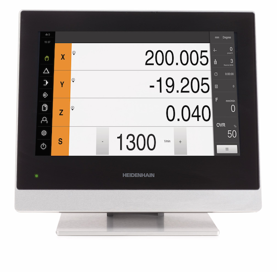

HEIDENHAIN’s new POSITIP 8016 digital readout (DRO) with touch screen is suited for manual machine tool applications. With its sturdy machined aluminum housing, this DRO promises to add reliability and ease-of-use to milling, drilling, boring and turning jobs.
The PT 8016 DRO has a multitude of functions including a taper calculator, bolt-hole pattern routine and tool radius compensator. This DRO also includes distance-to-go modes in both absolute and incremental and can control up to three NC analog, point-to-point axes and a spindle with the PT 8016 “ACTIVE Version”.
HMI
This new HEIDENHAIN PT 8016 DRO features a shop-hardened 12-in. color TFT touch screen for an IP65 front panel and an IP40 back panel. Users can plug-in up to six encoders – either 1 V-pp or 11 µA-pp incremental or absolute EnDat 2.2 pure serial. It has storage for up to 100 datums and 100 tool parameters, as well as the capability to create, store and execute programs.
The PT 8016 replaces HEIDENHAIN’s long-time workhorse the PT 880. It stands alongside the recently released ND 5023 and ND 7013 to round-out the new HEIDENHAIN family of digital readouts.
