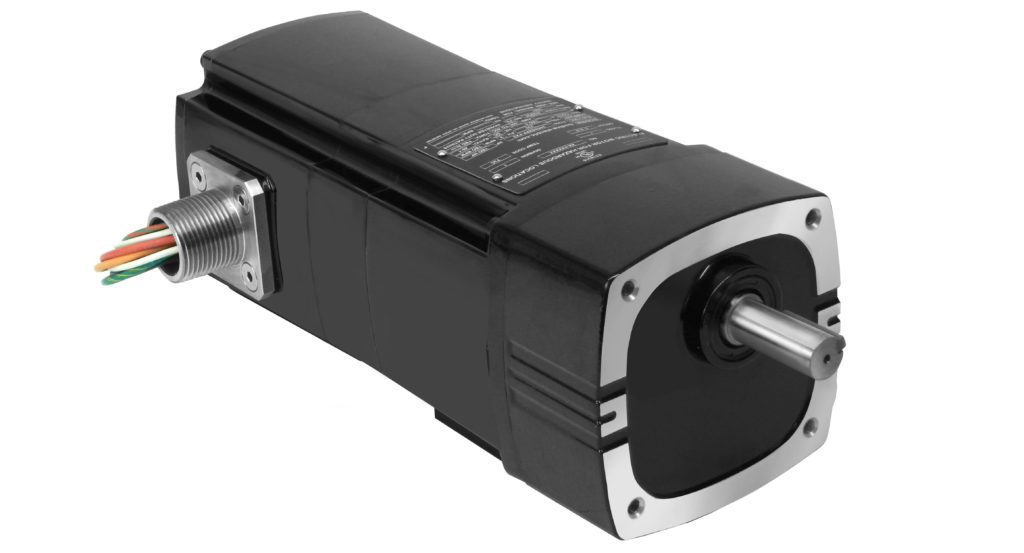

Bodine Electric Company introduces forty new Ex-Proof AC and BLDC gearmotors and four new motors, that are UL listed for use in environments where ignitable concentrations of flammable gases, vapors or liquids are likely to exist under normal operating conditions. These new CI/D1 geared motors combine Bodine’s high-performance type 34R6 (inverter-duty AC) or type 34B6 (brushless DC) motors with an integral parallel shaft type FX gearhead. Typical applications include chemical injection pumps for the oil and gas industry, automated equipment for use in aircraft hangars, petroleum refineries, dry cleaning plants, fuel servicing areas, chemical processing (cannabis distillation), or industrial coating and mixing facilities.
Class I, Division 1 Construction
These new gearmotors and motors meet National Electrical Code (NEC) Class I, Division 1 requirements, and are rated for use in areas where groups C and D flammable liquids are commonly found. The gearmotors meet UL temperature codes T3C and T4A. Both the type 34R6-FX (AC) and the 34B6-FX (BLDC) gearmotors and 34-frame motors are rated IP-66, meaning they can safely withstand water jets from any direction.
The initial product launch includes 40 standard gearmotor models with gear ratios from 5:1 to 300:1 with speeds from 5.3 to 560 rpm. Rated torque ranges from 46 lb-in (5 Nm) to 350 lb-in (40 Nm). Bodine Ex-Proof gearmotors and motors are available with low-voltage (12 or 24 VDC) brushless DC windings, and 230VAC or 460VAC inverter-duty, 3-phase windings. The CI/D1 AC and BLDC motors are available with two NEMA C face mounting options.
