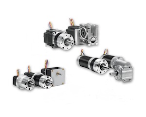

Vista, Cal., – Crouzet North America, a company of Custom Sensors & Technologies, announces a new line of high performance, geared BLDC motors available with a complete tool kit of selectable gear boxes, controllers, brakes and smart drives. The innovative concept allows different configurations to be quickly assembled for fast prototyping and provides a complete automated solution tailored to fit individual application needs.
The new BLDC motors feature a wide selection range for power, speed, torque and size. Motors include continuous power up to 400W, speeds between 1,500 and 6,100 RPM, and motor constants up to 15 ounce per square root Watt (103 mNm per square root Watt). Maximum torque constants feature up to 198 oz.-in./A (1400 mNm/A). The six new models include two round and four square designs with lengths ranging from 41 to 114mm. Motors can be ordered with a factory-mounted optical or magnetic encoder and can also be fitted with electro-mechanical fail-safe power off brakes.
Compatible gearboxes feature Spur, Planetary and Worm styles with torques from 0.4 to 120 Nm. The BDE30 and BDE40 external drives are offered in 6A or 14A max respectively. Internal drives are offered on BLDC motors that feature power ranges from 40 to 100W. A wide range of accessories are also available.
