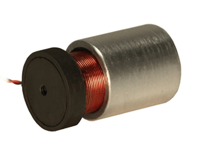

The new LVCM-010-013-01 linear voice coil motor from Moticont is only 0.375 in. (9.5 mm) in diameter and the length at mid-stroke is just 0.81 in. (20.7 mm) long. However, this new miniature voice coil motor has a high force-to-size ratio with a continuous force of 1.0 oz (0.28 N), a peak force of 3.2 oz (0.88 N), and a 0.25 in. (6.4 mm) stroke.
voice coil linear motor
A clean brushless dc linear servo motor which has high acceleration/deceleration and low inertia, the LVCM-010-013-01, is highly efficient, and suitable for a number of applications including haptic feedback in medical/surgical instruments, vibration damping, work holding and clamping, laser machining and drilling, assembly, sorting, packaging, sampling, scanning, laser beam steering and filtering, wafer handling, and pharmaceutical applications.
The LVCM-010-013-01 offers high accuracy and repeatability when operated as a dc servo motor in a closed servo loop using a position sensor.
This miniature linear motor has a 2-56 UNC-2B threaded mounting hole in the housing and a 2-56 UNC-2B threaded mounting hole in the coil end for easy integration into new and existing applications. A complete plug-and-play system including an encoder and servo controller is also available.
