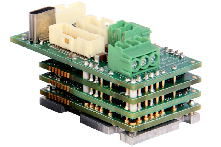

ADVANCED Motion Controls has released three new additions to the FlexPro servo drive family, the FM series. Designed with compact form and power density in mind, the micro-sized drives can outperform larger-sized digital servo drives and still be integrated into tight spaces. The new FM drives are equipped with an additional interface board that makes it easy to integrate into your system with standard connectors.
drives
FM060-5-EM and FM060-10-EM are connected to the power supply and motor using screw terminals, whereas the FM060-25-EM features pre-soldered connection leads.
