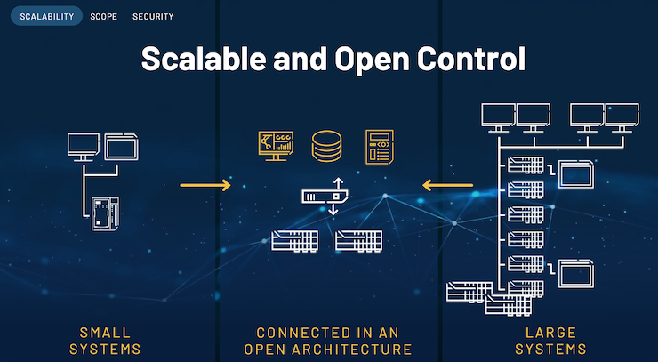

Integrated Architecture supports agility and scaling of project size with a common, open architecture, facilitating smart manufacturing for industrial automation systems.
