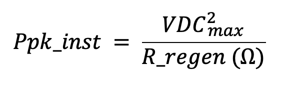

For the latter that means Vmax = VDC_max(fault) – 1 during normal operation (normal axis’ decelerations/stops) and during any e-stop or p-stop. For any selected regen resistor R_regen(Ω) the maximum shunt current from DC-bus capacitance may be calculated:
Within the defined application, the selected regen resistor maximum instantaneous or pulse, peak wattage is calculated:
The selected regen resistor’s capability must meet the following conditions:
1. Pc_resistor (wattage) > axis’ calculated required Pc_req.
2. Ppk_resistor (wattage) > axis’ calculated required Ppk_req (under all conditions).
