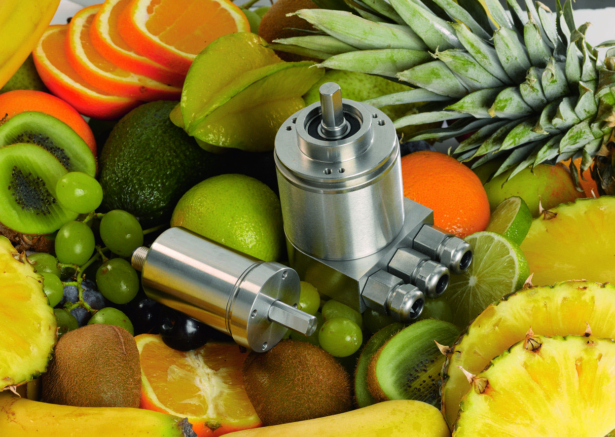

POSITAL’s IXARC stainless-steel rotary sensors are available with V4A-rated stainless steel housings and IP69K-level environmental seals. These rugged and versatile encoders are ideal for applications in the food and beverage industries since they can stand up to highly aggressive cleaning procedures and still deliver the reliability and measurement performance demanded by motion control systems.
The stainless-steel housings are also available in explosion-proof (ATEX-rated) designs that can operate safely in environments with potentially dangerous levels of explosive dust or gases. These models are ideal for grain or flour-handling facilities. More after the jump.
