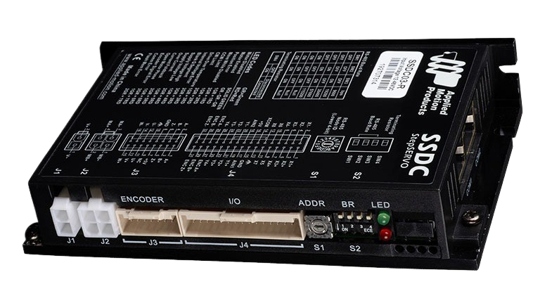

For systems based on EtherNet/IP, Applied Motion Products’ ST, SSDC, TXM, and STF products (including the SSDC03-IP StepSERVO drive shown here) provide seamless integration with PLC-controlled networks and IT/OT connectivity.
