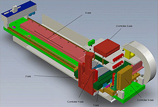

The use of new, miniature single axis motion controllers enables an innovative cabling concept. Each axis carries its own peripheral controller connected with motor, encoder and sensors by means of short, stationary cables. The peripheral controllers are connected by a high throughput data bus system that allows interpolated movements between different axes. Thus, the number of moving cables (one power, one data bus) is independent of the number of axes in a system.

How? Replace central multi-axis motion controllers with single separate control modules mounted directly to the axes.
These modules, connected by a high-speed bus interface, even allow interpolated movements between different stages.

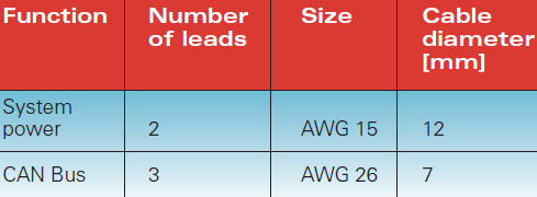

By miniaturizing the electronic PCBs, the size and mass of the individual control boxes is smaller than a comparable cabling system. For a 3-axis XYZ system, instead of a huge number of moving wires, there are three moving control modules, a tiny three wire shielded CAN-bus cable in a daisy chain configuration and two wires for power.
In total, the complete system needs just two separate cables with diameters of 7 mm and 12 mm independent of how many axes the stage system includes. The five electrical leads are easy to handle in one moving cable carrier.
Each axis carries its own motion controller independently. All leads to motor, sensors, and encoder systems have a length of typically less than 20 cm. More important, all the electrical connections to the upper axes are static, which means there is no bending or relative movement of the cables.
