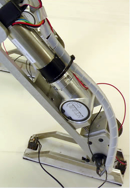

robot-uses-right-angle-gearhead-maxonIn one specialty application, A&M researchers recently put maxon right-angle gearheads into a bipedal robot. The Bipedal Experimental Robotics Lab (AMBER) built the human-like bipedal walking robot (called the AMBER 2) in an effort to advance robotics of this design to practical uses in disaster response, military operations, elderly assistance, rehabilitation, and prosthetics.
The AMBER 2 robot uses three motors and three right-angle gearheads per leg, one for each joint—ankle, knee, and hip. At first the team used the maxon motors along with another vendor’s right angle gearhead, but high torque and misalignment-related vibration quickly broke the joints.
“We … needed a seamless package to maintain tight tolerances for the joint mechanisms,” said lead researcher Dr. Aaron Ames.  When the robotic foot hits the ground, the motors have to reverse on impact, which causes a huge amount of torque on the motor—so here, the AMBER 2 uses maxon’s brushless motors.
