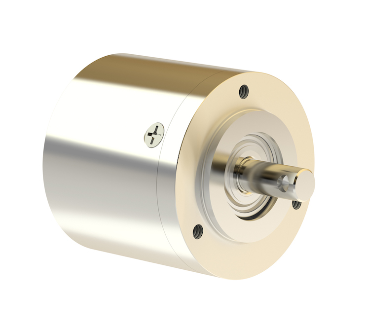

With the TRK38, TWK introduces an ultra-compact single-turn magnetic encoder developed with safety-oriented applications in mind. With a diameter of only 38 mm and a length of also 38 mm, and a weight of 60 g, the sensor is suitable for mounting in confined installation spaces.
The TRK38 detects position and speed in a safety-oriented manner and fulfils the requirements of SIL 2 (IEC 61508) and Performance Level d (EN 13849). The position resolution is 16 bits per revolution. The certified EtherCAT FSoE interface ensures reliable transmission of the safety-related signals to the higher-level controller or to a safety relay, as well as programming of the sensor.
encoders
Despite its very compact dimensions and high-quality design, the TRK38 is also competitively priced with alternative devices such as sine-cosine and incremental encoders. And the aluminum housing and overall design enable long service life even under conditions such as vibration and shock loads. The non-contact, wear-free measuring principle makes a significant contribution to this.
