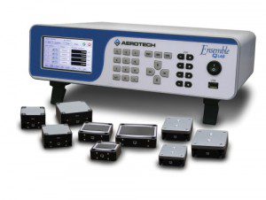

1-Aerotech-Piezo-QLab
Shown here are Aerotech QNP-L linear stages, QNP-XY stages, and QNP-Z (Z-axis) piezostages with a QLAB controller. Aerotech’s new Q-Series piezo nanopositioning stages and drive electronics include feedback, bearings, power electronics, and controls designed from the ground up—a costlier approach but one that supports the trend towards atomic-level positioning resolution, repeatability, and accuracy. “We also design a lot of our own metrology equipment in house … by using commercially-available instruments such as laser interferometers and other sensors, but integrating them in machines to get high-accuracy measurements quickly. This lets us guarantee the performance of our systems without taking days or weeks of time to perform the necessary measurements. It’s very easy to talk about nanometer-level performance, but it is much harder to prove it,” said O’Connor.
