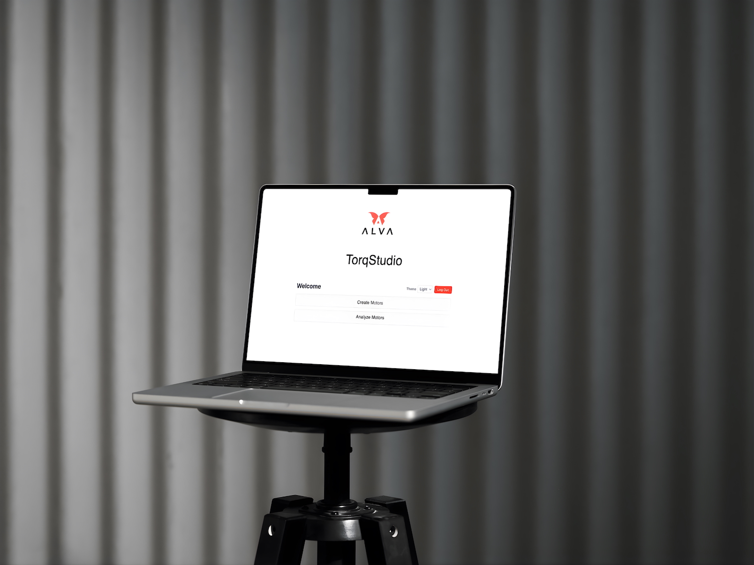

A new company called Alva Industries now offers a similar software tool for procuring custom motors. Called TorqStudio, this online platform was first shown at the Smart Production Solutions or SPS 2025. The software combines motor simulation and design — from the exploration of concepts to detailed performance verification before machine builders have to commit to hardware.
TorqStudio brings powerful motor simulation and design capabilities directly into the hands of engineers. Image: Alva Industries
For motor creation, the engineer just defines their required motor size. The platform then automatically generates an optimized motor variants with different tradeoffs in motor mass, motor constants (Km), torque capabilities, and efficiency.
It’s entirely analytical so results come in milliseconds instead of minutes or hours. Every generated motor is mathematically accurate, physically realistic, and manufacturable. [The company’s] Users can also analyze any motor created within the software or from a stock catalog of torque motors and frameless motors.

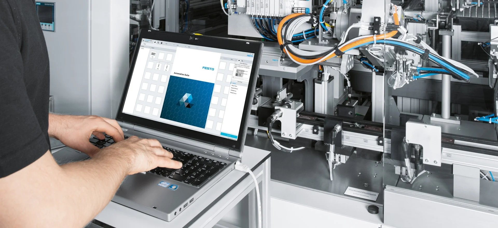

Festo software speeds the commissioning of automated systems.
