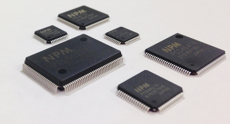

motion control chip
Nippon Pulse’s PCD46x1A series is ideal for engineers that worry that pulse control LSIs are too expensive compared to just a CPU for their motion control applications. The PCD46x1A series features three chips ranging from single axis to 4-axis control. They’re suitable for engineers who haven’t used pulse control LSIs before, and for those who need basic, uncomplicated motion control functions.
