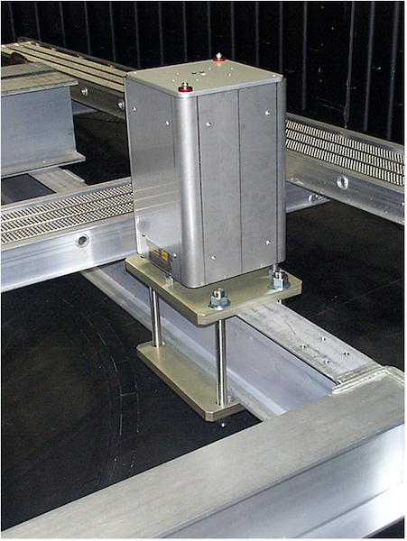

vibration isolators
One of three Negative- Stiffness vibration isolators used on the Cryogenic Telescope Assembly, Spitzer Space Telescope.
(Courtesy of Ball Aerospace/NASA/JPL)
