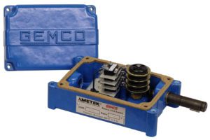

What are geared cam limit switches?
Image credit: Ametek
Electromechanical switches are often placed at the ends of linear axes to indicate the limits of travel. But for applications with rotary — rather than linear — motion, geared cam limit switches can perform a similar function by tracking rotations of the motor shaft and triggering switches to stop movement when the specified number of rotations has been reached.
To measure shaft rotations, geared cam limit switches — also referred to as rotary limit switches — use a geared input and a series of cams. The input shaft of the rotary switch assembly is coupled to the motor, and as the motor shaft rotates, it turns the input gear. Cams are mounted concentrically with the gears, so as the gears turn, the cams rotate, and rocker arms attached to the cam lobes trip switches at set positions.
