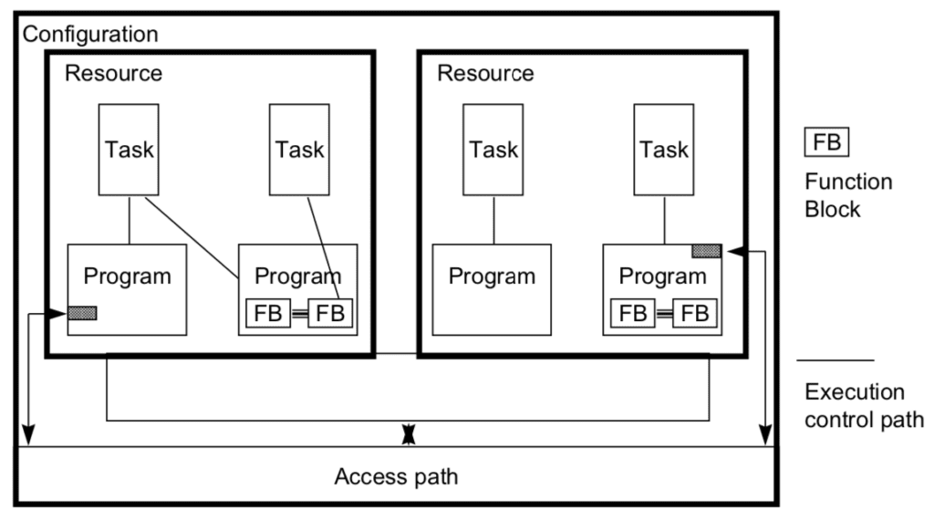

The software model for PLCs, as defined in the IEC 61131-3 standard, Programmable Controllers – Part 3: Programming Languages, consists of, at the top level, a configuration. The configuration defines the hardware structure and logic of the PLC system and contains resources (the PLC or PAC, for example), which are able to execute programs. These resources are controlled by tasks, which invoke the execution of software blocks that make up the PLC project. These software blocks are referred to as Program Organization Units.
IEC 61131-3 defines three types of program organization units (POUs) — programs, function blocks, and functions.
The IEC 61131-3 software model for PLCs includes a configuration at the top level, with resources and tasks that execute the program organization units.

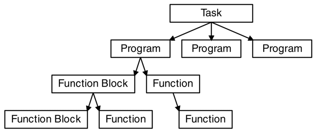

Function blocks can be called by programs or by other function blocks, and in some implementations of IEC 61131-3, they can be called by tasks. The memory that will capture and store the output must be allocated for each unique instance of the function block — a process sometimes referred to as instantiation, since it creates an “instance” of the function block.
Programs can be called by tasks. Function blocks can be called by programs or by other function blocks. Functions can be invoked by any POU type.
