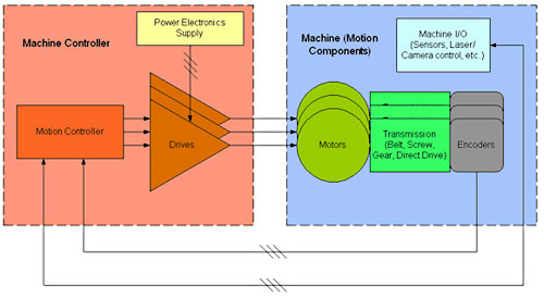

To understand how vendors define high-performance motion control in engineering terms, first divide the motion-control system components into two sections: the machine and the machine controller. The machine controller includes components that actively control the system. The machine itself consists of the components that are controlled or manipulated. That is, the motion controller is just one component of the machine controller. The motors, mechanics, and other machine components have a direct impact on machine performance, but to evaluate performance in terms of motion control, these components are considered “fixed.”
A high-performance motion control system is comprised of the machine and the machine controller. The machine includes physical components and sensors in the system. The machine controller consists of the components actively controlling the system based on information provided by the machine sensors (here, the PLC is assumed to be part of the motion controller.)

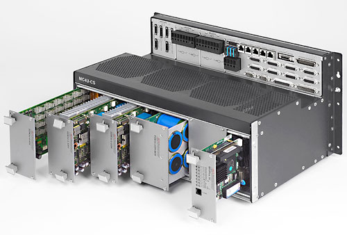

Integrating control components: When different components of a machine controller are physically separated, communications between them impede performance. Standard protocols such as EtherCat, CANOpen, and SERCOS that connect each component can make a clean control solution for connectivity and user friendliness, but this method does not allow for the most advanced servo features like MIMO control.
In addition, this approach requires intelligence at each control system component. A better approach for high-performance multi-axis control integrates all machine-control components, that is, controller, drives, power supply, and PLC all into one product. This allows for MIMO control, advanced servo, and drive control techniques of multiple axes from a single controller, and a clean solution requiring virtually no machine control component interfacing from the user. An example of this is in the ACS Motion Control MC4U, a complete integrated package with multi-processor computer architecture designed to achieve the highest performance. In addition, this approach saves cost by offloading all intelligence to the motion controller instead of requiring it at each drive node.
A high-performance machine controller integrates several components, such as the ACS Motion Control “MC4U Machine Control,” which provides a modular machine control platform for seamless integration of components and achieves the best possible performance.
