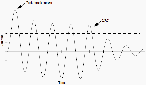

The highest level of inrush current occurs during the first half-cycle of motor operation and can be more than 10 times the motor’s full-load current. As the motor beings to move, the current decreases to the level of the motor’s locked rotor current, which is often six to eight times the motor’s normal operating current. As the motor speed — and, therefore, back EMF — increases, the current further decreases, until normal operating speed and normal operating current are reached.
inrush current
The initial spike in current is the inrush current, which quickly decreases to the level of the motor’s locked rotor current (LRC) before finally reaching the normal operating current:

Locked rotor current is the current a motor will draw when the rotor is blocked or has not yet started to move. The terms “inrush current” and “locked rotor current” are often used interchangeably, but depending on the context, they can refer to different phenomena.
The U.S. Department of Energy explains the difference between inrush current and locked rotor current this way:
“Instantaneous peak inrush current is a momentary current transient that occurs immediately (within half an AC cycle) after contact closure. Locked rotor current is the root-mean-square (RMS) current that is established following the peak inrush; the current remains near the locked rotor value during acceleration until the motor approaches its operating speed. The terms inrush current and starting current are often used to mean locked rotor current.”
