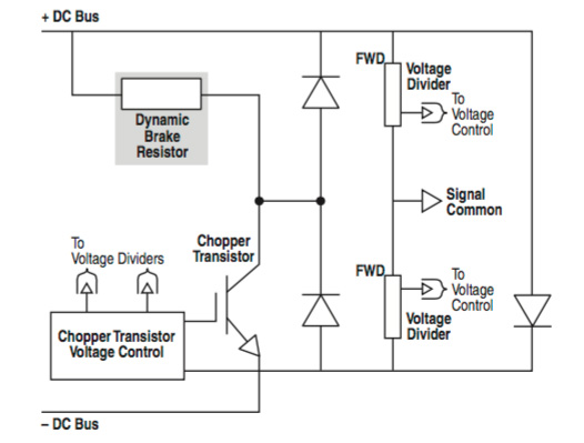

Dynamic braking takes the energy generated by the motor and releases it as heat through a voltage-regulated IGBT (insulated-gate bipolar transistor) to a resistor. In some applications, one or multiple resistors are mounted remotely, where the heat they generate does not affect other electrical equipment. In these cases, the combination of the switching devices (IGBTs) and the control circuit is typically referred to as a “chopper module.” Traditional dynamic braking circuits are rated for low duty cycles — typically 20 percent or less — while chopper circuits are used for higher duty cycles.
dynamic braking
With dynamic braking, an IGBT (transistor) allows power to flow to a resistor, where it’s dissipated as heat.
Image credit: Rockwell Automation, Inc.
There are two common control methods for dynamic braking — hysteresis control and pulse-width modulation (PWM) control. Hysteresis control monitors the level of DC bus voltage and turns the IGBT on when the voltage reaches a predefined “high” level, allowing current to flow to the resistor and be converted to heat. When the DC bus voltage drops to a predefined “low” level, the IGBT is switched off.
Pulse-width modulation control, on the other hand, switches the IGBT on-and-off continuously via a control algorithm and monitoring of the DC bus voltage, so torque ripple is greatly reduced. PWM control is primarily used when multiple drives are connected to a common DC bus, to avoid having one drive doing a disproportionate share of the dynamic braking work.
