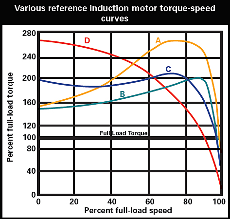

The ac induction motor dominates the constant speed and variable speed markets. The premium efficiency three-phase induction motor has been undergoing improved efficiency ratings dictated by the U.S. Department of Energy (DOE). (One of the key factors in the drive toward better motor efficiency has been government mandates, specifically DOE directives for better efficiency from electric motors. [See sidebar.]) The recent regulations cover a number of different general purpose 2, 4, 6 and 8-pole induction motors. In Figure 1, Design A, B and C performance curves represent the majority of 1 to 500 hp general purpose ac induction motor torque-versus-speed performance curves.
Various-reference-induction-motor-torque-speed-curves
Fig. 1: These design performance curves represent the majority of 1 to 500 hp general-purpose ac induction motor torque-versus-speed performance curves.
