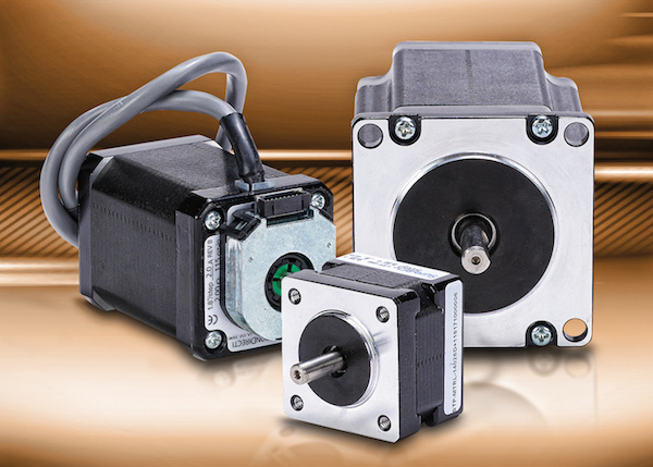

New stepper motors, encoders and inertia dampers have been added to the SureStep system of step motor control. SureStep series high-torque industry-standard NEMA 14, 17, 23, and 34 stepper motors now provide holding torque from 8 to 1,288 oz-in. The new smaller frame size NEMA 14 motors (1.4-in. wide) start at $22.00 and are available in single and dual shaft versions.
The SureStep family has options for open loop control (no encoder), position monitoring (external encoder feedback), and position verification (integrated motor/drives with internal encoder). Replacement and optional encoders (starting at $42.00) are available for standalone dual-shaft motors and standard integrated motor/drives in all NEMA 14, 17, and 23 sizes.
stepper motor
Fixed resolution encoders are available in 400 pulses per revolution (ppr) and 1,000 ppr; new configurable encoders allow resolution selection from 48 to 4,096 ppr (the default is 400 ppr). A free downloadable configuration utility autodetects the encoder and allows ppr selection.
New step motor inertia dampers (starting at $13.00) smooth out steps in a typical step motor, resulting in a quieter and smoother motion when rotating between steps. The dampers also reduce resonance and possible micro oscillations when moving from step to step and can be used as a hand wheel to directly rotate the position of the rotor when power is removed from the motor.
SureStep Stepper System motors, encoders and dampers are CE approved and backed by a one-year warranty.
