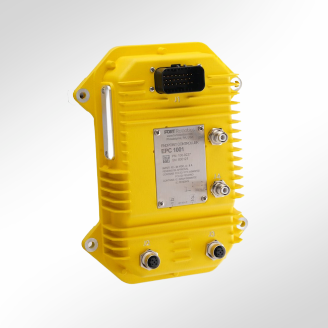

FORT Robotics’ Endpoint Controller, which brings safe, secure, dynamic wireless control to mobile, automated, or autonomous machines, has received SIL 3 (safety integrity level 3) functional safety certification, as defined by IEC 61508, from exida.
The controller, which is part of the FORT Robotics Control Platform, can send and receive two different SIL 3 safety commands over Wi-Fi or Ethernet and can communicate with up to 30 machines simultaneously. This makes it possible to command and manage machines on- or off-site, delivering scalable, efficient control while protecting people and assets.

FORT’s Endpoint Controller functions as both a transmitter and a receiver of SIL 3 safety commands. Deploying an SIL 3–certified product helps users comply with safety regulations and ensures that potential risks have been assessed and mitigated. While in the past, this level of reliability was limited to wired hardware, the evolving automation landscape requires the ability to send functionally safe commands over any network, including wireless communication. FORT’s product is one of only a few certified wireless solutions on the market.
“As mobile and autonomous machines become common drivers of productivity, companies must have a reliable means to send safety commands over wireless networks to ensure employees can monitor, respond, or stop machines from a distance if an unsafe scenario emerges,” said FORT CTO Nathan Bivans. “Certification from one of the world’s most trusted safety experts in exida means the device will work as intended, when intended, reducing the risk of harm to people or damage to the equipment.”
The Endpoint Controller can be mounted on a machine or integrated with third-party input devices, such as buttons, safety interlocks, light curtains, or fire alarms, allowing users to trigger automatic wireless communications with a fleet of machines or robots. Additional features include a tamper-proof design, an IP65-rated enclosure, and secure firmware to protect against cybersecurity threats.
