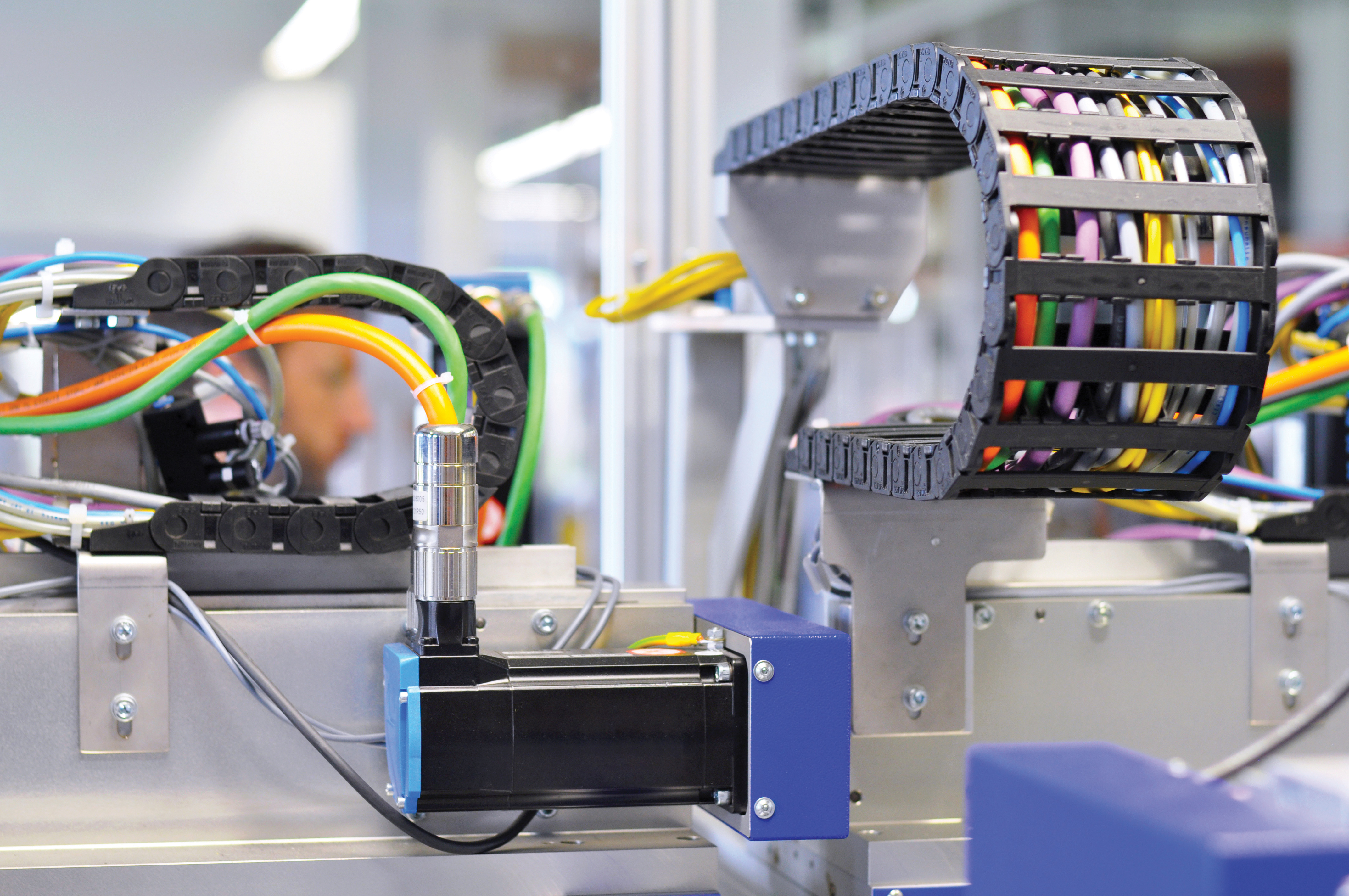

Flexible cabling for communications (and power as well)
Flexible cables, or continuous-flex cables, are cables specially designed to cope with the tight bending radii and physical stress associated with motion control applications. These highly flexible cables were developed with unique characteristics to differentiate them from standard designs. These are sometimes called chain-suitable, high-flex, or continuous-flex cables.
A higher level of flexibility translates into an increase in service life for a cable inside a cable carrier. A regular cable typically manages 50,000 cycles, but a flexible cable can complete between one and three million cycles.
Flexible cables can be divided into two types; those with conductors stranded in layers inside the cable, and those that have bundled or braided conductors.
Stranding in layers is easier to produce, and therefore usually less expensive. The cable cores are stranded firmly and left relatively long in several layers around the center and are then enclosed in an extruded tube-shaped jacket. In the case of shielded cables, the cores are wrapped up with fleece or foils.
However, this type of construction means that during the bending process the inner radius compresses and the outer radius stretches as the cable core moves. This can work quite well because the elasticity of the material is still sufficient, but material fatigue can set in and cause permanent deformations. The cores move and begin to make their own compressing and stretching zones, which can lead to a “corkscrew” shape, and ultimately, core rupture.
Continuous flex cable
The other construction technique involves braiding conductors around a tension-proof center instead of layering them. Eliminating multi-layers guarantees a uniform bend radius across each conductor. At any point where the cable flexes, the path of any core moves quickly from the inside to the outside of the cable. The result is that no single core compresses near the inside of the bend or stretches near the outside of the bend, which reduces overall stresses. An outer jacket is still required to prevent the cores untwisting. A pressure filled jacket fills all the gussets around the cores and ensures that the cores cannot untwist. The resulting flexible cable is often stiffer than a standard cable, but lasts longer in applications where it must constantly flex.
Selecting the right flexible cable for an application starts with a few fundamental parameters. First, determine the application type. Will the cable be stationary or will it be moving? If the latter, is the motion mainly flexing or is there torsional motion involved? Or does the application call for both flexing and torsion? Different applications have customized cables for that application.
