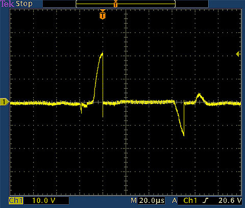

Induced shaft currents show up as common-mode voltages when measured with an oscilloscope probe touching the shaft.

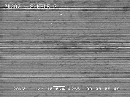

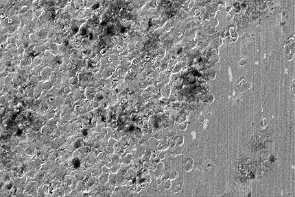

Viewed under a scanning electron microscope, a new bearing race wall appears as a relatively smooth surface. However, in VFD-driven motors, tracks eventually form where ball bearings contact the wall. With no electrical discharge, the wall is marked by nothing but this mechanical wear. Without proper grounding, VFD-induced electrical discharges can quickly scar the race wall.
Frequent discharges riddle the bearing race with pits, which are commonly called frosting. During virtually every VFD cycle, the induced currents discharge from the motor shaft to the frame via the bearings and produce small fusion craters in ball bearings and the bearing race wall. The damage eventually leads to noisy bearings, but by the time such noise is noticeable, bearing failure is often imminent.
The amount of fluting produced comes from the operational frequency of the VFD. This causes pitting that concentrates along the bearing race wall and forms washboard-like ridges. Fluting can cause excessive noise and vibration. In an HVAC system, the noise may be magnified and transmitted throughout the entire building via ductwork.

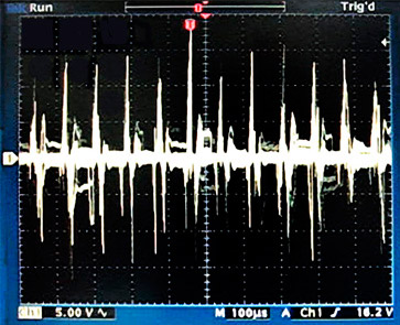

Voltages measured with an oscilloscope probe can be seen to repeatedly build up on the rotor to a certain threshold, then discharge in short bursts along the path of least resistance, which often runs through the motor’s bearings to the frame (ground). Serious bearing damage is probably more likely in systems that operate with high carrier frequencies, a constant speed, or inadequate grounding.

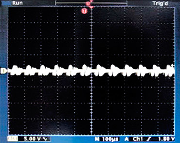

Without some form of mitigation, VFD-induced shaft currents (shown on top oscilloscope screen) can cause considerable motor-bearing damage. The screen on the bottom demonstrates how effectively the AEGIS SGR™ reduces these currents and the damage they cause by channeling them safely to ground. Its patent-pending Electron Transport Technology™ uses the principles of ionization to boost the electron-transfer rate and promote extremely efficient discharge of the high-frequency shaft currents.

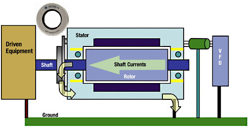

• Alternative discharge paths to ground are preferable to insulation because they neutralize shaft current. These techniques range in cost and sometimes can only be applied selectively, depending on motor size or application. The ideal solution would provide an effective, low-cost, very-low-resistance path from shaft to frame and could be broadly applied across all VFD/ac motor applications. This affords the greatest degree of bearing protection and maximum return on investment.

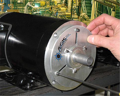

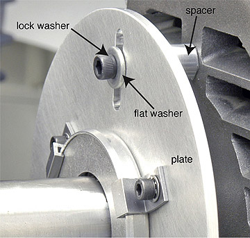

When installing a single SGR on a small motor, the motor’s drive end is the preferred location. The AEGIS SGR comes in two versions — a continuous ring for most NEMA- and IEC-frame motors and a split-ring design which allows installation in the field, around larger shafts, without the need to disassemble attached equipment. A mounting adaptor included with every NEMA or IEC model SGR facilitates installation of the device on motors with shaft shoulders, slingers, bearing caps, or end-bell protrusions. In critical applications where motors with two ceramic bearings are specified, at least one SGR should be used to ensure that shaft voltage does not pass down the line to attached equipment such as gearboxes, pumps, encoders, pillow-block bearings, or break motors.
For most larger motors, the best bearing protection may be obtained by installing an SGR on the drive end of the shaft and insulation on the non-drive end.
All the above approaches work to some degree, but the most effective solution comes from Electro Static Technology’s AEGIS SGR Bearing Protection Ring™, designed with special conductive microfibers. The ring redirects shaft currents and provides a reliable, very-low-impedance path from shaft to frame, which bypasses the motor bearings entirely.
The AEGIS SGR is scalable to any NEMA or IEC motor regardless of shaft size, horsepower, or application. They are on power generators, gas turbines, ac traction and break motors, clean-room motors, HVAC systems, and other industrial and commercial applications.
For VFD-equipped motors of less than 100 hp (75 kW) with shaft diameters of less than 2 in. (50mm), a single SGR on the drive end of the motor shaft is typically sufficient to divert shaft currents. Large ac motors (100hp/75kW or more) and even large dc motors, especially those with shaft diameters of more than 2 in., are more likely to have high-frequency circulating currents and discharges that can damage bearings. Motors with roller bearings are also more vulnerable to the circulating currents because they have a greater surface area and their lubricant layer is usually thinner. Such motors benefit from the combination of an SGR on the drive end and insulation on the non-drive end to break the circulating current path. This may also work where installing an SGR on the non-drive end would be impractical because of encoders, fans, or other features.

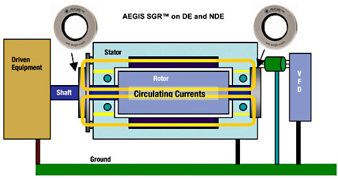

Two SGRs are recommended for some larger motors.
An SGR is also a common solution for motors above 500hp (375kW), and most manufacturers already take this approach. However, when insulation on the drive end is not designed into the motor or cannot be easily installed, two SGRs are recommended — one on the drive end (DE) and one on the non-drive end (NDE).
Close-up of an SGR installed with mounting plate and standoff posts (spacers).
