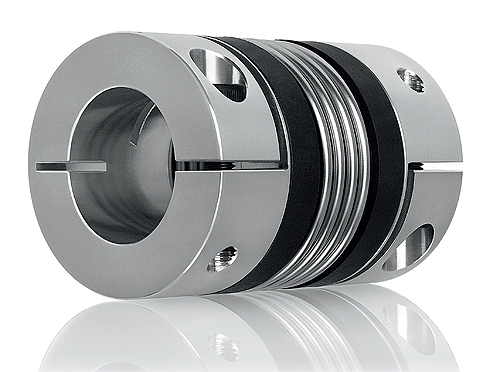

Bellows couplings excel in motion-control applications that require precision control despite shaft misalignment. If an application requires precision, understand the performance factors critical to selecting a bellows coupling suitable for the task.
bellows-coupling
This is a bellows coupling.
They are flexible with zero-backlash.
Note that there is a difference between backlash (which is a true mechanical clearance, such as that which is found between gear teeth) and torsional deflection, or wind-up, which all components exhibit to some degree. Most couplings are preloaded to eliminate backlash or are inherently backlash free, like the bellows coupling. But they all have different levels of torsional stiffness, which is often traded off for lateral flexibility during the coupling selection process. Bellows couplings have very high torsional stiffness, do not handle quite as much misalignment as others, but also do not impose heavy reaction loads onto the shafts and bearings as they flex.
Key benefits of bellows couplings include misalignment compensation and precise transmission of velocity, positioning and torque. Bellows couplings are known for their exceptional torsional rigidity, and flexibility in dealing with axial, angular and parallel shaft misalignment. Bellows couplings are typically made from a stainless-steel tube hydroformed to create deep corrugations that make them flexible across axial, angular, and parallel shaft misalignments. The bellows absorbs any slight misalignments between the mounting surfaces of two components.
Bellows couplings also absorb slight misalignments from perpendicularity and concentricity tolerances between the mounting surfaces of the two connected components. Plus bellows couplings tend to have the highest torsional stiffness of any coupling paired with servomotors, and are common in applications requiring highly precise positioning.

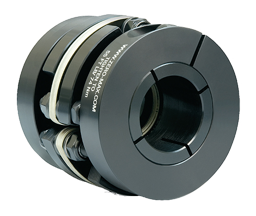

Composite disc-packs: Rugged disc couplings
Most disc couplings feature a metal disc-pack. However, Zero-Max’s CD coupling features a uniquely shaped disc-pack that is constructed of a special composite material rather than metal. This composite material provides an alternative over metal disc couplings. The advantages include its ability to absorb shock and vibration, its misalignment capacity, electrical isolation and elimination of fatigue and fretting, common failures of metal disc couplings. Whereas metal disc couplings may be less expensive initially, overall cost of composite disc couplings usually will be lower because they are maintenance free and are rated for long life.
composite-disc-coupling
This is a composite disc (CD) coupling from Zero-Max.

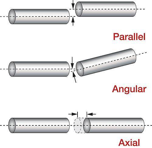

The ability to accommodate misalignment is a critical aspect of a flexible disc coupling. Misalignment between coupled shafts often exists due to manufacturing tolerances, improper installation, or from loads on the system.
coupling-discs
Coupling discs are usually designed of metal. The lower right disc pack from Zero-Max is made of rugged composite material for highest performance.
Parallel, angular, and axial misalignment between coupled shafts should all be examined to see if the coupling selected is up to the task. It is important to know a coupling’s misalignment rating as well as the stiffness rating. The stiffer a coupling, the higher the reaction load misalignment will transmit to the coupled items. These reaction loads will have a negative effect on the life of the system. To limit these reaction loads, the Zero-Max composite disc couplings are designed less radially stiff than metal disc couplings. Therefore, they transmit lower reaction loads on the coupled equipment and thereby increase the life of connected (and often expensive) components.
coupling-misalignment
All three types of misalignment shown transmit reaction loads to a system. Select the correct coupling design to limit forces that arise from misalignment.
The amount of misalignment that a system can experience will typically determine the selection between a single-flex (one flexible disc-pack) and a double-flex (two flexible disc-pack) coupling. While more compact in size than the double-flex variety, a single-flex coupling will have lower misalignment capacity and higher reaction loads.
A common misconception is that single-flex disc couplings cannot accommodate parallel misalignment. Although this is true for metal disc couplings, the design of the disc-pack used in the Zero-Max CD coupling allows the single-flex CD coupling to accommodate limited parallel misalignment. This permits designers to implement a single-flex disc coupling into designs that may not have space for a double-flex coupling.
