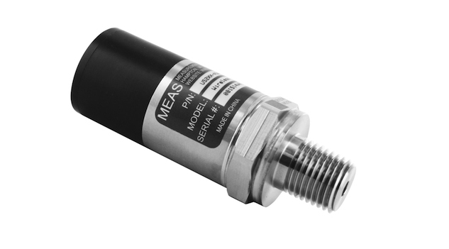

Taking advantage of the increasing presence of wireless networks in industrial applications, the U5600 is a wireless pressure transducer from TE Connectivity. The transducer is housed in a stainless steel and polycarbonate body, eliminates the need for hard wiring and provides remote control and monitoring using Bluetooth 4.0.
