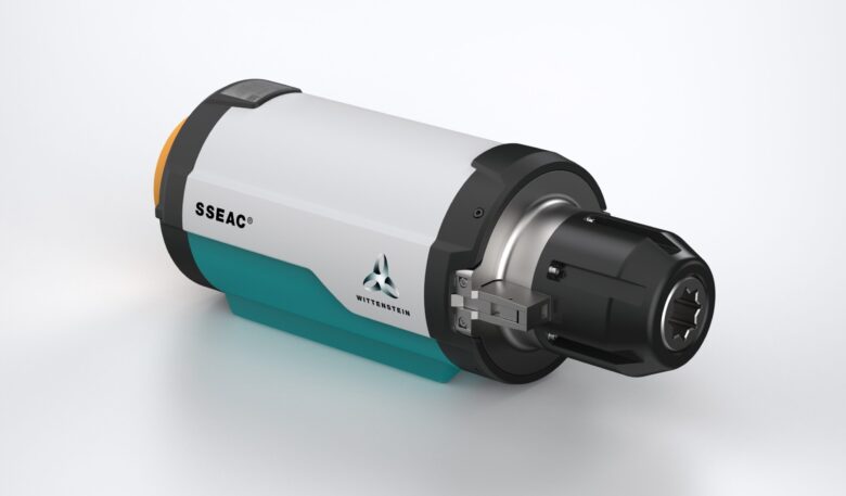

The SSEAC is a new electromechanical subsea actuator from Wittenstein Motion Control (WMC) for actuating choke and other valves in subsea applications. Rated for a service life of at least 25 years, this actuator controls the continuous flow of gases and liquids at a depth of up to 4,000 m. As an alternative to hydraulic systems traditionally chosen for this purpose, the SSEAC has two redundant 24 V motors that drive the actuator’s planetary gearbox and enable precise rotary adjustment of the valves. The subsea actuator is designed for use in offshore oil and gas extraction, systems for injecting CO2 into the seabed, or the production, transport, and storage of green hydrogen at sea.
The new SSEAC from Wittenstein Motion Control can provide torques of up to 2,700 Nm at depths up to 4,000 m. Image: Wittenstein
