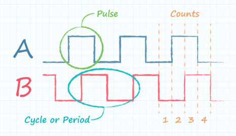

But what counts as a pulse may have different definitions depending on the manufacturer. For instance, some encoder manufacturers denote a pulse as only the high portion of the square wave pulse an encoder produces. Think of a single cycle of a square wave composed of a high (logic “1”) and low (logic “0”) portions of the signal. So the pulse is the high portion, and represents one whole cycle of high and low.
encoder
The drawing illustrates the several ways encoder resolution can be defined; as pulses, cycles, periods, or counts per revolution. (Image via CUI Inc.)
Complicating things further is the fact that some manufacturers use different terminology that may denote the same or a different definition. For example, one alternative measure is cycles per revolution (CPR). This refers to one complete cycle of high and low and is equivalent to the PPR measure. However, another measure, counts per revolution (CPR), refers to the actual number of states in a quadrature encoder, which for one complete square-wave cycle is 4, and is not equivalent to cycles per revolution nor PPR.
The bottom line is to do one’s due diligence; check to make sure what PPR or CPR refers to in specifications for an individual encoder.
